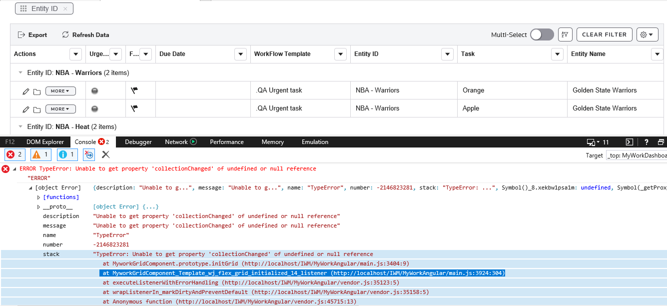

    Error Image: 1. Error at initGrid 2. When EntityID is grouped Sorting is not getting added to that column

  • Posted 27 April 2021, 5:39 am EST
    Hi Sneha,
    Indeed passing the null parameter as the initial value is causing the issue. To fix the issue what you should do is pass an instance of collectionView with an empty array and then when data from the service is fetched assign it to the sourceCollection property of the collection view. Refer to the following code snippet:

  • Posted 30 April 2021, 3:45 am EST
    From the code snippet I could observe that inside the onBindData method you are changing the this.data value with new array, it will cause the grid to create a new collection view, You need to change the following code

  • Posted 3 May 2021, 4:45 am EST
    Hi Sneha,
    In the attached component.ts file, I noticed that the following code line #505
    this.data.sourceCollection = new wjcCore.CollectionView(griddData, {
              pageSize: this.pagenationInfo.pageSize,
    the sourceCollection property expects the data to be of array type, so changing the above code to following should fix the issue:
    this.data.sourceCollection = griddData;
    this.data.pageSize = this.pagenationInfo.pageSize;
    If the issue persists, please share a working sample that we could execute and debug at our end.
