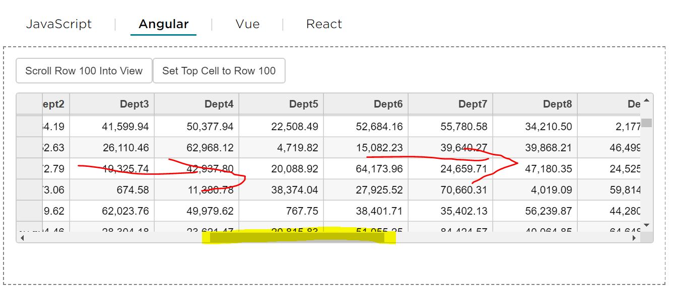

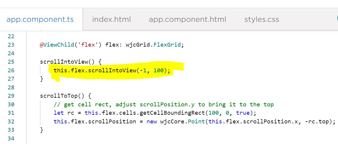

    There is a method on FlexGrid known as scrollIntoView. This method is used to scroll a row and/or column into view. Now, if you need to scroll horizontally, then just set the row parameter to -1 and provide the column index (like 100) and call this method.
    Demo: https://www.grapecity.com/wijmo/demos/Grid/PagingScrolling/ScrollingandViewRange/purejs
    This demo shows how to scroll to a row but you can update the method to scroll to a column.
    API Link: https://www.grapecity.com/wijmo/api/classes/wijmo_grid.flexgrid.html#scrollintoview

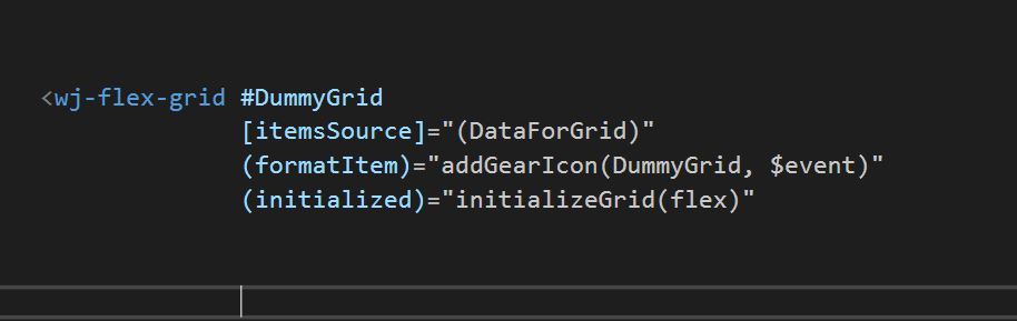

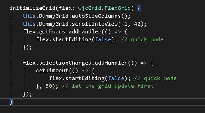

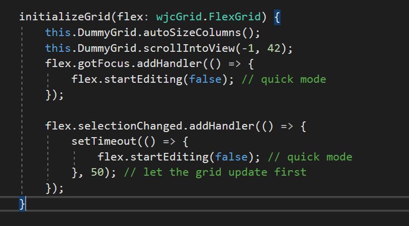

    See the attached image of given code

    It seems that your issue is that if we press the left/right button of the scrollbar using mouse, then it does not scroll to the extreme left/right in a continuous movement. Is this your issue? If not, can you provide a video or a screenshot which depicts your issue?
  • Posted 14 August 2020, 2:42 am EST
    One more thing i noticed in this, grid scrolling start only when mouse cursor pointer touch left or right side of screen. Not grid side or grid container side.
    Please let us know also this, how we over come this.
  • Posted 14 August 2020, 2:48 am EST
    I think there seems to be a gap between our understanding. Using mouse, scrolling only occurs if you use mouse wheel, drag the scrollbar or click on the scrollbars buttons. I am not sure what are you referring to by this line:
    Can you please elaborate your issue and provide a screenshot/video?
