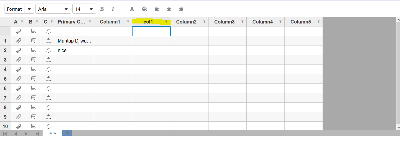

    I would like to customize column’s name for new column I create with column function (Add New Column) instead of generated default by system “col1”.
    Could you help me with that ? Thanks.

    Hi Oskar,
    You may handle the columnChanged event and change the header of the inserted column accordingly:
    onColumnChanged(s, e) {
    	if(e.added) {
    		s.columns[e.index].header = 'Column ' + e.index;
    Please refer to the sample below:
