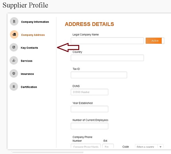

    What control could i use to create sidebar menu(please see attachment)
    Requirements: on click on the top level (no child/items) provide some action
    I was trying tabPanel (attachment show tabPanel as a side menu). Looks good but i found some tabPanel limitations for my scenario:
    1. for complex tab area with big chunk of database data tabPanel loaded/reloaded all tab at once at any get/post action.
    2. always load tab 0 on page load. I create separated page instead of each tab with the visually identical tabPanel on each. When i try to make specific tab as active it’s come back to tab 0 and as a result load page 0.
