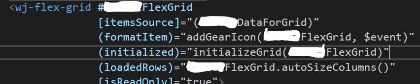

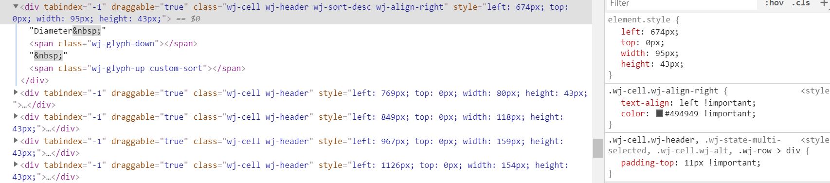

    A. sort code in Html

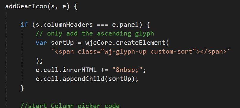

    B. sort code in TS

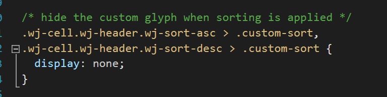

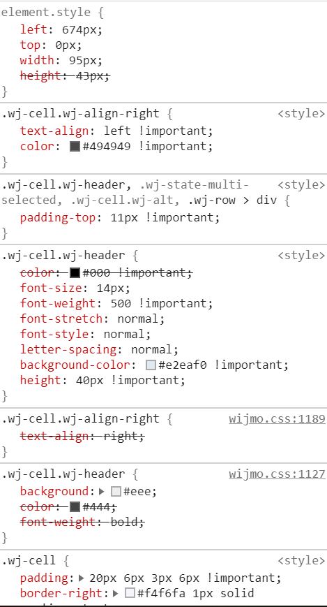

    C. Sort code in CSS

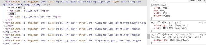

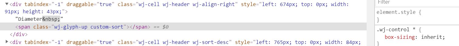

    D. Inspect Element view: Default UP arrow
    E. Inspect element view : down arrow
    Hope this images and attached video link help to detect, exact reason our side .

    Regarding #1, on the first click, the column is sorted in ascending order, therefore, the glyph does not change as the custom glyph added is the same as of the ascending order glyph. We cannot change this behavior but we can change the display. So, I have updated the sample so that color, when sorting is applied, is different from when it is not applied. Please refer to the sample link below:
    https://stackblitz.com/edit/angular-v9hyhd
    Regarding #2, does the slow sorting only happens after adding the glyph customization? Also, in the loadedRows event, you are calling autoSizeColumns. This may also cause the performance issue as auto-sizing columns is an expensive process.
    Try removing the handler and let me know whether this resolves the performance issue.
