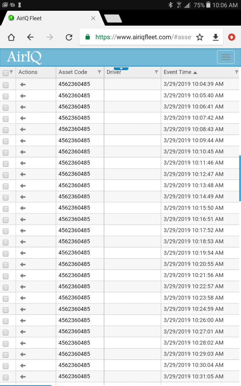

    I’m having a issue with wijmo3 splitter. It’s get to be remain constant some time even i press the splitter to go down.
    What I found, splitter clickable part is very small. It’s difficult to click precisely on it in mobile devices. When the user clicks, the rows in the grid is getting selected.
    Is there any way i can implement swipe gestures on the splitter to push it down when user swipe downwards on the top of the button or any other solution to resolve it.
    Please find the attachment.

    You could explicitly set the size of the splitter using some CSS. Please refer to the code snippet below:
    .wijmo-wijsplitter-h-expander {
     height: 13px !important;
    .wijmo-wijsplitter-v-expander {
     width: 10px !important;
    You may also refer to the following sample demonstrating the same:
    http://jsfiddle.net/4f3cwm27/
