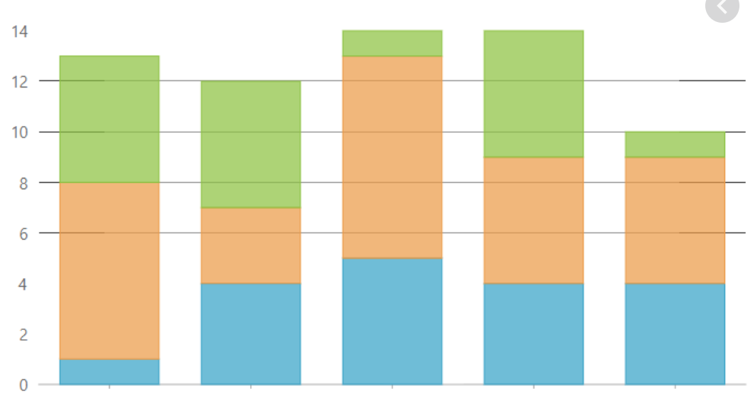

    Does wijmo supports stacked column graph?
  • Posted 10 February 2020, 11:24 pm EST
    Hi Aishwariya,
    FlexChart has a stacking property that can be used to stack like this. Just set the value of this property to wijmo.chart.Stacking.Stacked:
    flexChart.stacking = wijmo.chart.Stacking.Stacked;
    Refer to the demo below:
    https://www.grapecity.com/wijmo/demos/Chart/Bar/StackedBar/purejs
    In this demos, if you will change the chartType to Column, the chart will become like the image:
    let barchart = new chart.FlexChart('#chart', {
    	header: 'Country GDP',
    	chartType: chart.ChartType.Column,
