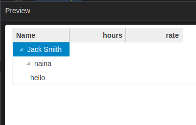

    HI All,
    i am using [childItemsPath]=“[‘children’,‘products’]” but its not showing all the data properly.
     getWorkers() {
            return [{
                children: [{
                    children: [{
                        children: [{
                            children: [{
                                children: [{
                                products: [{
                            products: [{
                        products: [{
                    products: [{
                products: [{
    Should show children node if children present and if products array is there then show below the children node

  • Posted 16 October 2023, 7:29 am EST - Updated 16 October 2023, 8:07 am EST
    HI Anirudh
    The requirement is like the below structure
    wijmo Header Columns like- productID, ProductNAme,ProductDesc etc
    ->main category-Name(TreeNode)
    –>children(TreeNode)
    —>products grid if the product array is there.(Wijmo Grid structure
     getWorkers() {
            return [{
                children: [{
                    name: 'Main Category',
                    children: [{
                        children: [{
                            children: [{
                                children: [{
                                products: [{
                                    productName: 'hello4'
                            products: [{
                                productName: 'hello'
                        products: [{
                    products: [{
                products: [{
    Should show children node if children present and if products array is there then show below the children node) Like This
