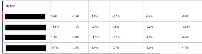

    Dear Team,
    We are using Angular 12 and the Transpose Wijmo grid. But there is a bug from the accessibility team that when we zoom to 400% they are not able to see other columns as the first one is frozen (attached screenshot)
    How to resolve this issue, how should make the scroll work for 1 column as well? It’s already in Production and customers have escalated it will be helpful if we can get some input from your team as we can’t find anything in the documentation

    Hi Sumita,
    I am sorry for the inconvenience caused. As the first column is frozen so it will not be scrolled. However, to display content of other columns you may wrap the PivotGrid’s hostElement in a container and can then make that container scrollable.
    Please refer to this below provided code snippet:
    In html file:
      <div id="container">
        <wj-pivot-grid #grid [itemsSource]="ng"></wj-pivot-grid>
      </div>
    In the css file:
    #container {
      height: 220px;
      overflow: auto;
      width: 500px;
    .wj-pivotgrid {
      width: fit-content !important;
    Please refer to this sample for reference: https://stackblitz.com/edit/angular-12-form-validation-imjk4z

    Thank you, Anirudh, I used the Pivot grid and did some item formatting it’s what we needed.
