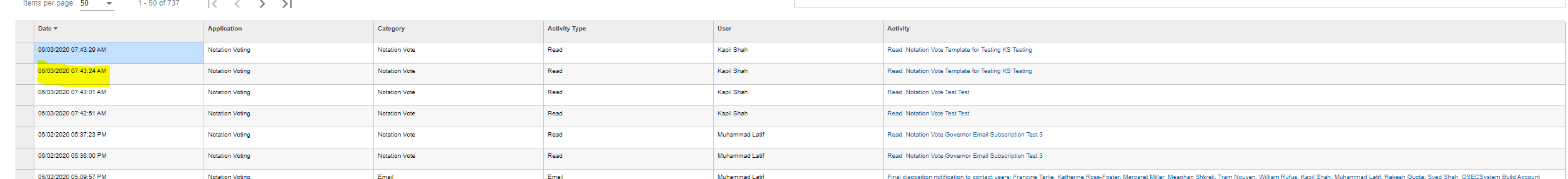

    We recently upgraded our application from Angular 7 to Angular 9.

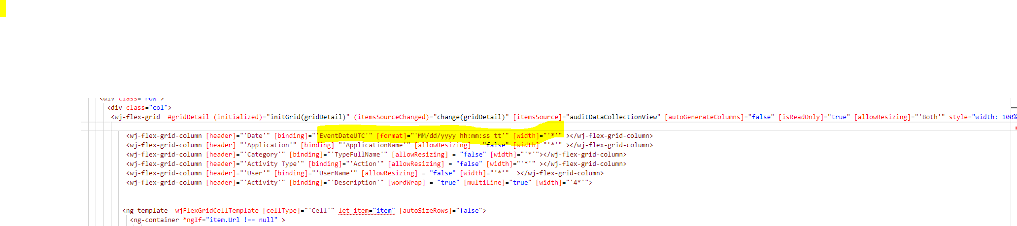

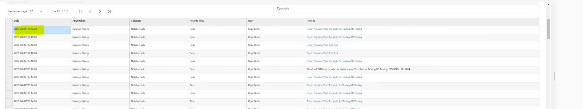

    One of the columns in Wijmo Grid is a date which we display in [format]=“‘MM/dd/yyyy hh:mm:ss tt’” in Angular 7

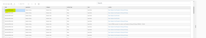

    After upgrading to Angular 9, I lose the date format

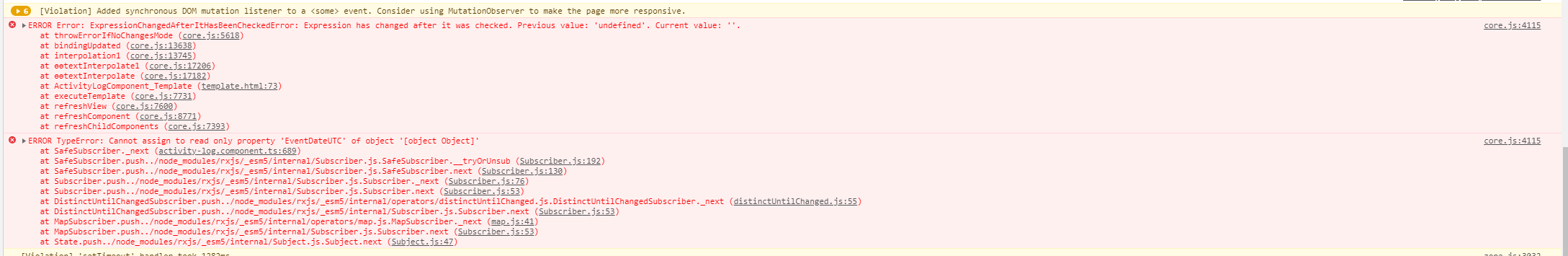

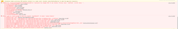

    Angular 9 Errors
    So is the issue with Wijmo grid not supporting the format in Angular 9?

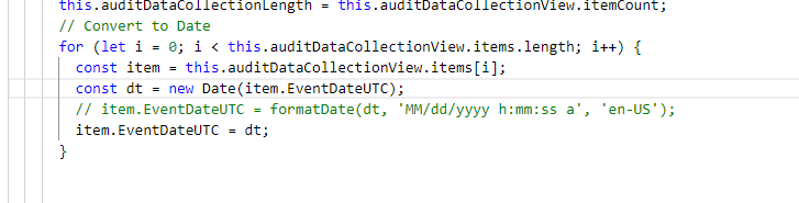

    It seems that the issue is related to angular and wijmo. When the data is returned from the API, you create a CollectionView with the data and then iterate over each item to convert EventDateUTC to a date. Can you please try to upgrade the EventDateUTC before the assigning the data to the collectionview.
    It seems that the EventDateUTC property is read-only property. Can you please try to assign a new value to it outside the loop and check if the error is thrown or not?
