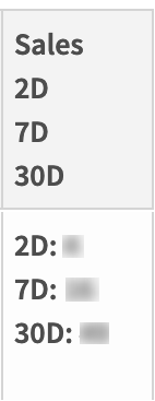

    I have attached a screenshot of what I am trying to achieve. I have multiple columns that I would like to condense and show in one column. In the image you can see the column headers stack as well as the corresponding data.
    Is this possible with Flexgrid or is there any similar functionality?
  • Posted 19 March 2019, 8:03 am EST
    Hi Eric,
    If you need to show the data only i.e read-only mode then you may simply handle the formatItem event and display the required data. However, if you also need to let the user edit the data then you need to use the multirow control instead of FlexGrid. Please refer to the following sample to get started with the multiRow: https://demos.wijmo.com/5/PureJS/MultiRowIntro/MultiRowIntro/
    ~Sharad
