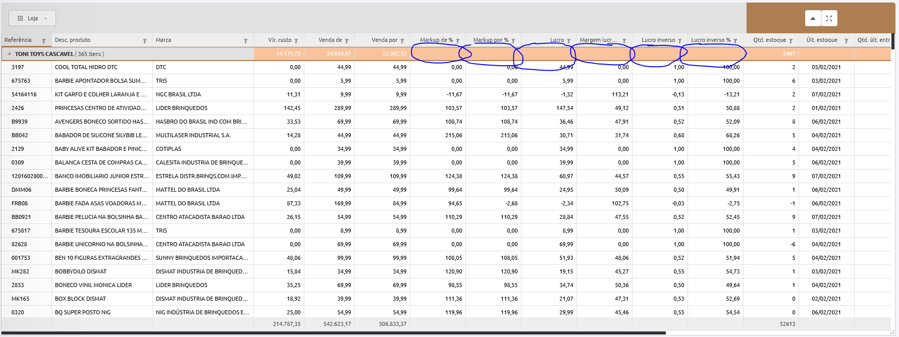

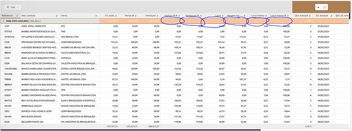

    When grouping, I have the totalizers in the grid, but it is not a sum, avg, …, I need to make a formula with the totals (example GROUP_C = SUM_GROUP (A) / SUM_GROUP (B). Attached is an image with the example.

    You may use the formatItem event to set the custom aggregate. Please refer to the following demo which demonstrates the same:
    https://www.grapecity.com/wijmo/demos/Grid/Aggregation/Customaggregation/vue
    In the demo, the aggregate of profit column is calculated dynamically.
