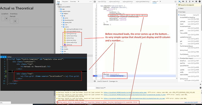

    I am trying to render a simple grid with simple data. Per your online documentation and other examples I have the following libraries included and registered in the project and loading on the website:
    • “wijmo.min.js = version 5.20202.699”
    • “wijmo.input.js = version 5.20202.699”
    • “wijmo.grid.min.js = version 5.20202.699”
    • “wijmo.vue2.min.js= version 5.20202.699”
    The error on load
    vue-v2.6.12.js:637 [Vue warn]: Error in mounted hook: "** Assertion failed in Wijmo: function CellFactory(){} expected. Error
        at assert (https://localhost:44302/assets/scripts/lib/wijmo/wijmo.min.js:14:11450)
        at Object.asType (https://localhost:44302/assets/scripts/lib/wijmo/wijmo.min.js:14:12763)
        at FlexGrid.set [as cellFactory] (https://localhost:44302/assets/scripts/lib/wijmo/wijmo.grid.min.js:14:75024)
        at DirectiveCellFactoryBase [as constructor] (https://localhost:44302/assets/scripts/lib/wijmo/wijmo.vue2.min.js:14:1199)
        at new DirectiveCellFactory (https://localhost:44302/assets/scripts/lib/wijmo/wijmo.vue2.min.js:14:91266)
        at WjFlexGridBehavior._createControl (https://localhost:44302/assets/scripts/lib/wijmo/wijmo.vue2.min.js:14:87947)
        at WjFlexGridBehavior.WjComponentBehavior._prepareControl (https://localhost:44302/assets/scripts/lib/wijmo/wijmo.vue2.min.js:14:13311)
        at WjFlexGridBehavior.WjComponentBehavior.lhMounted (https://localhost:44302/assets/scripts/lib/wijmo/wijmo.vue2.min.js:14:11819)
        at VueComponent.mounted (https://localhost:44302/assets/scripts/lib/wijmo/wijmo.vue2.min.js:14:11097)
        at invokeWithErrorHandling (https://localhost:44302/assets/scripts/lib/vue/vue-v2.6.12.js:1868:65)"
    I included a screenshot of the full example and syntax of my implementation…I dont understand why this error is thrown on rendering before almost any code is executed. I have a breakpoint at the mounted function of the vue control which you can see that nothing else has executed in the javascript and this error is already in the console… any help is appreciated. Also note that I have other wijmo controls which are currently loaded and fully functional in the same page such as a wj-auto-complete control.

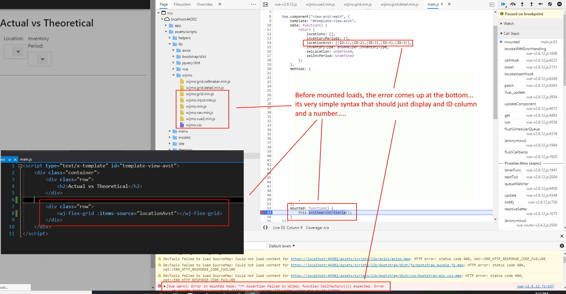

    The picture did not upload with the original post, here it is
