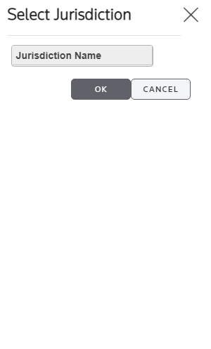

When i doubleclick on grid table data is rendered other wise empty
Posted by: bemes9226 on 23 June 2021, 4:36 pm EST
    Posted 23 June 2021, 4:36 pm EST - Updated 3 October 2022, 12:03 pm EST

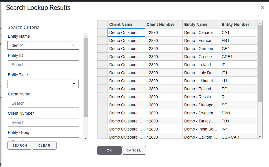

    grid data not loaded, when i click dbl click on jurisdiction headername data is loaded.checlk below screnshot;
    this.data = new wjcCore.CollectionView(this.JurisdictionLookup);
    this.data.filters.push(
    this.getFilterMethod.call(this, “JurisdictionName”, “JurisdictionName”)
  • Posted 25 June 2021, 12:12 am EST
    data is available in this.data but not render
  • Posted 25 June 2021, 6:55 am EST
    Hi bemes9226,
    Please check your this.getFilterMethod.call(this, “JurisdictionName”, “JurisdictionName”) method. It is possible that none of the items pass this filter due to which the grid becomes empty.
  • Posted 25 June 2021, 7:08 am EST - Updated 3 October 2022, 12:03 pm EST
    that issue resolved.

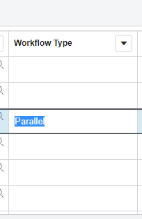

    when i click cell data is visible,other wise it is hiding
  • Posted 27 June 2021, 11:13 pm EST
    This means that you may have added Cell type cell template on the HTML but it does not render anything. Please make sure that you either remove this template or add the required template to display the text.

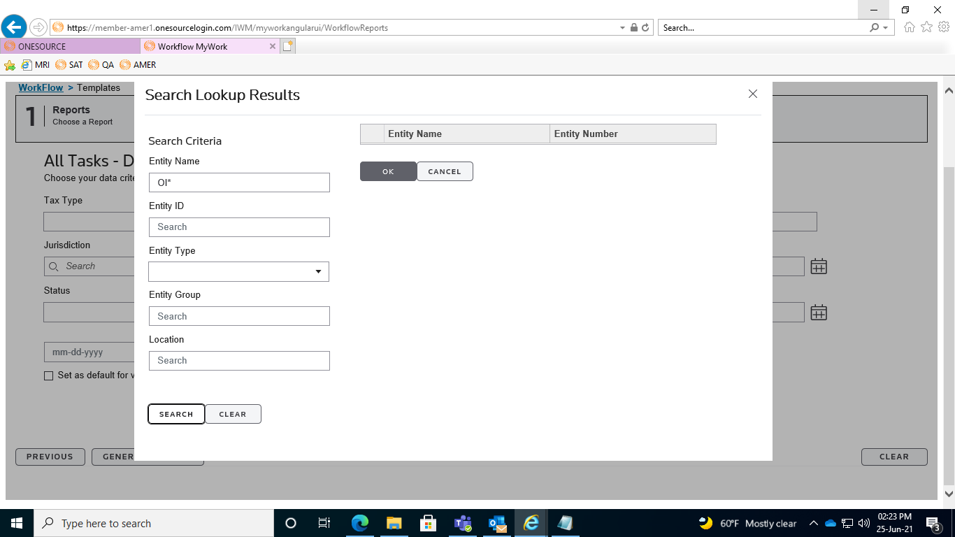

    i have one input field when i type something in text “ame*” related data filter in grid.
    ame*(Search with asterisk symbol )

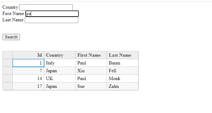

    i have searched firstname as “pa” but got other data check below

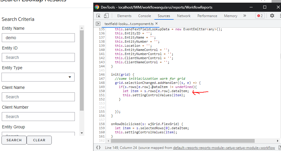

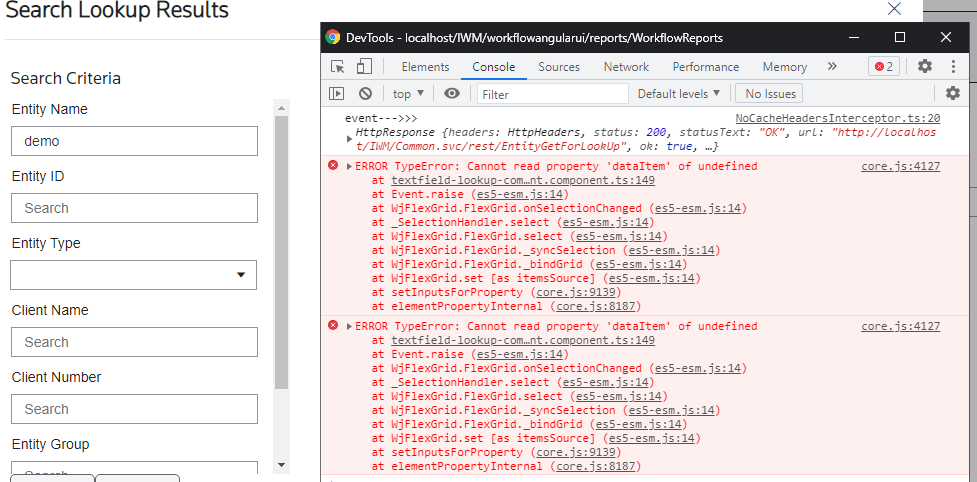

    1)when i search with * it working fine without error.
    2)when i search same in without *.
    data not getting(empty data) am getting dataItem undefined error

    search with * working as expected, but search without * not filtering data it is empty
  • Posted 2 July 2021, 2:35 am EST - Updated 3 October 2022, 12:04 pm EST
  • Posted 2 July 2021, 5:31 am EST
    Sorry for the inconvenience, I have fixed the issue and updated the sample. Please refer to the updated sample below:
    https://stackblitz.com/edit/angular-9-0-0-rc-1-zkuzgf
