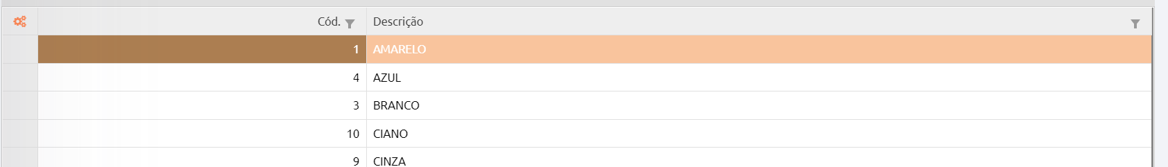

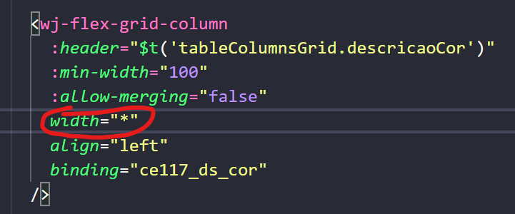

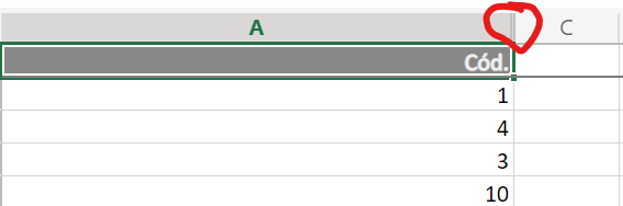

    I ran into an issue.
    I’ve setted the width of a column to “" and it works just fine in the application. But when I export the table as an Excel document, all the rows that are marked with "” are shown in Excel with a tiny row. I wanted it to get the min-width value but I’m not achieving it. I’m sending a photo of how it is in the app, how’s the code and how it rendered.
  • Posted 23 December 2020, 4:51 pm EST
    Hi Luis,
    We are sorry but we are unable to replicate the issue at our end. Could you please have a look at the following sample and let us know if we are missing something in order to replicate the issue:
    https://codesandbox.io/s/wijmo-vue-forked-j7b84?file=/src/components/HelloWorld.vue
    You may also share a fresh sample replicating the issue for us to investigate. Also, please share the exact wijmo version you are using so that we may test using the same version too.
