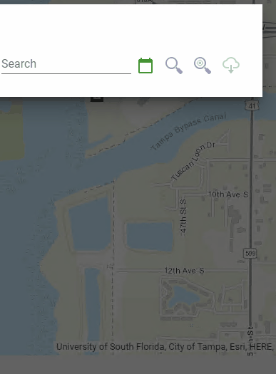

    Wijmo calendar didn’t respond anything if I click on the same date which I previously selected. Attached is the gif.
    I want to close the calendar window when I click on the same date.
    Please suggest.
