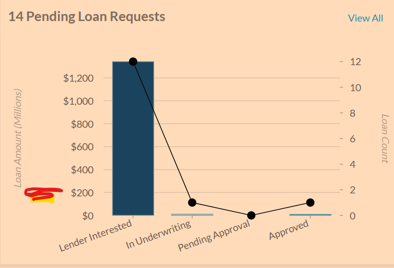

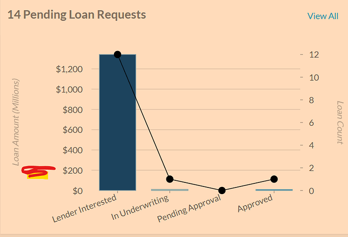

    I want to reduce the marked space between chart and information labels.
  • Posted 9 September 2019, 12:07 am EST
    To reduce the gap between the axis title and the axis line, you may handle the rendered event of FlexChart and change the “y” attribute of the axis title:
    let axisYLabel = elements.querySelector('.wj-axis-y g text');
    axisYLabel.setAttribute('y', (+axisYLabel.getAttribute('y')) + 20)
    You may also refer to the sample below:
    https://stackblitz.com/edit/angular-lwtpgl
