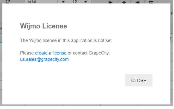

    Can you let us know what exact issue occurs in the application? If the license is not set properly, then a Popup will be displayed when the webpage is loaded, can you please provide a screenshot of the popup?
    Also, make sure you set the distribution key using the setLicenseKey method before initializing any of the controls. Since you are using Angular application, you can set the key in the main module file (app.module.ts).
