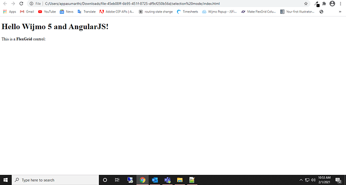

  • Posted 1 February 2021, 1:24 am EST - Updated 3 October 2022, 2:34 pm EST
    Hi Ashwin,
    the file which you have shared is not generating any grid.
    please refer to the below screenshot.
    Am I missing something? Please help me with this…
  • Posted 1 February 2021, 1:42 am EST
    Ohh, I think angularjs is being loaded properly in the sample. In the index.html file, update the CDN link of angularjs to this:

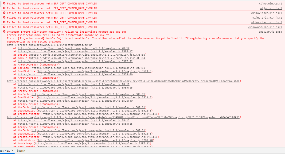

  • Posted 1 February 2021, 2:13 am EST - Updated 3 October 2022, 2:34 pm EST
    Here is the error log from console.

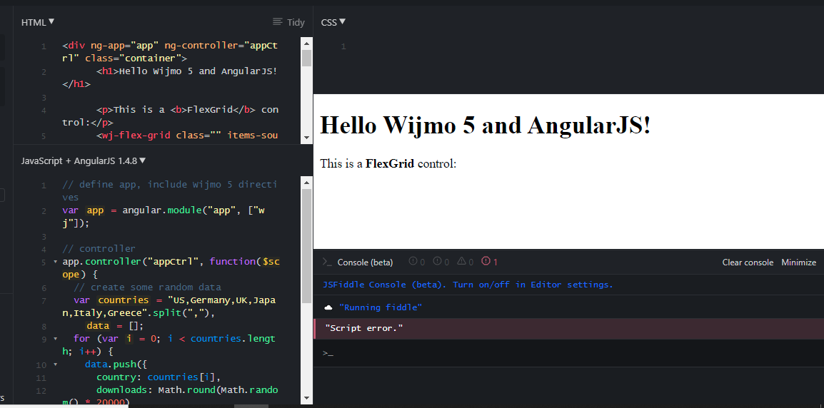

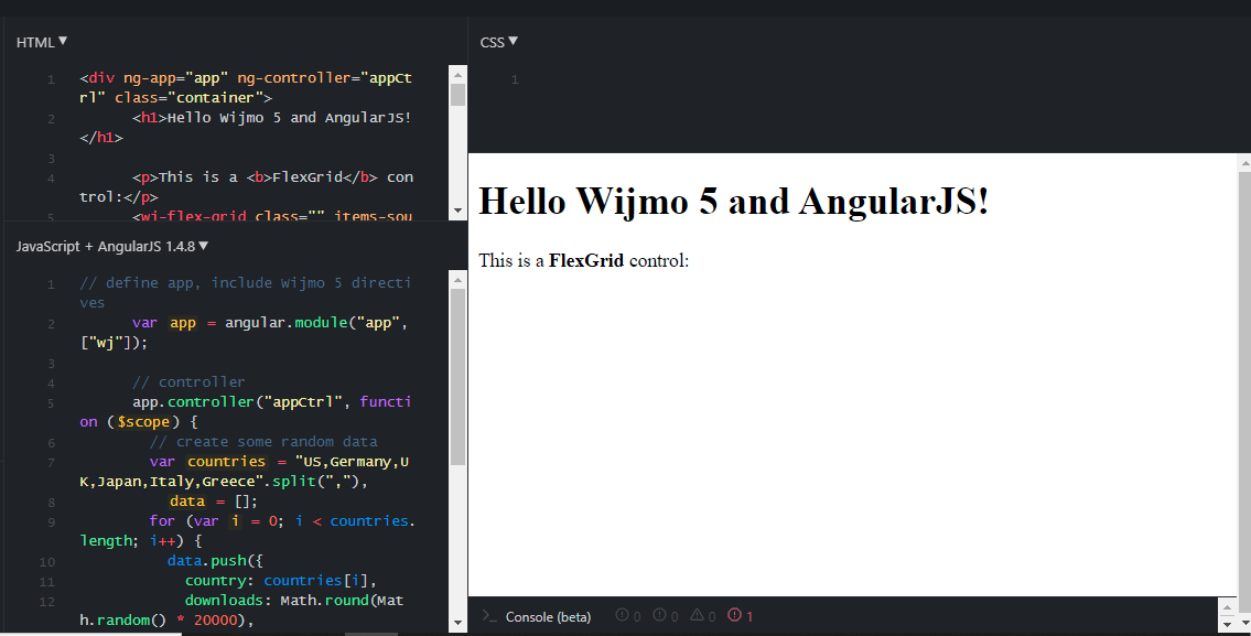

  • Posted 1 February 2021, 2:21 am EST
    It seems that Wijmo is not being loaded properly in the sample. I have created an online sample for this:
    https://jsfiddle.net/knqrch2w/2/
  • Posted 1 February 2021, 2:29 am EST - Updated 3 October 2022, 2:34 pm EST
    Still Not able to see the output. Day hasnt started well yet.
  • Posted 1 February 2021, 5:33 am EST
    Hi Ashwin, I found the issue. Issue is with cdn’s. I have modified them and working. will try to fix in the code. Thank you
