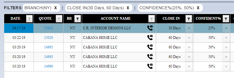

    I am using Wijmo flex grid pure js.
    How to clear the filter on the column?
    We are showing applied filter details as text above the grid with a close button.
    On click of button(X) we need to clear/remove that particular filter from the grid.
    Below is the sample code we are useing to show applied filter on the grid.

  • Posted 1 May 2019, 2:06 pm EST
    Below code works for me.
    Please suggest if there is a better way to do this.!!

  • Posted 2 May 2019, 5:31 am EST
    In order to remove the filter, you could use the clear() method of ColumnFilter class. Please refer to the code snippet below:
    function ClearThisFilter(e) {
        var f = filter.getColumnFilter(e.id); // get the curren column filter
        f.clear(); // Clear the filter
        gridDefault.collectionView.refresh(); // refresh the collectionView
        $(e).parent().remove(); // remove the chip
    You may also refer to the sample below:
    https://jsfiddle.net/rhs89naj/
    API Reference:
    • clear method:
    https://www.grapecity.com/wijmo/api/classes/wijmo_grid_filter.columnfilter.html#clear
    •ColumnFilter class:
