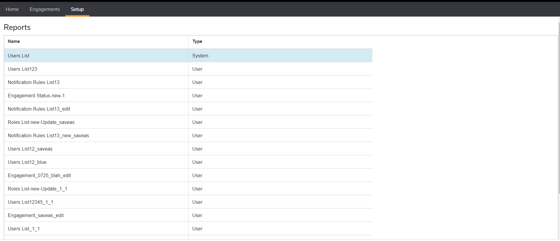

    I am facing issue with wijmo grid resize.The wijmo grid is not automatically resizing on container(like div) width change.
    The rows and columns are not resizing and living a white space.
    below is the code for my grid

    [img]https://gccontent.blob.core.windows.net/forum-uploads/file-cfac24d0-5ce1-4f58-9da1-ee92733bb149.PNG[/img

    Hi Sagarika,
    We are sorry but we were not able to replicate the issue at our end. Please refer to the sample below that we used to replicate the issue. Could you please tell us whether we are missing something in order to replicate the issue?
    https://stackblitz.com/edit/angular-ekb8p3
    Also, please ensure that you are not setting the width of FlexGrid or the container explicitly.
