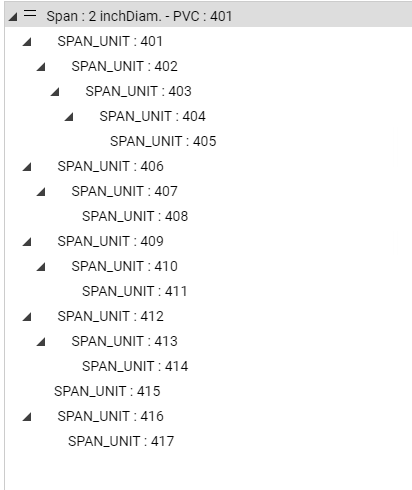

    While clicking on a node, my wijmo tree grid’s selection looks inappropriate after I toggle the node to collapse & expand. It just works fine unless until I click on collapse/expand of a node. Here is my code.

    Please note, the selection while on click goes inappropriate only after collapse/expand a node.
    Please let me know what I’m doing incorrectly.

    Attached is the gif.
    You can see it before collapse/expand the selection works just fine. But after it, the selection goes incorrect.

  • Posted 7 February 2020, 3:15 am EST
    It seems like this issue is similar to the issue posted in the following thread:
    https://www.grapecity.com/forums/wijmo/wijmo-grid-selecting-paren
    Please let us know whether the solution in the above thread solves this issue or otherwise.
  • Posted 7 February 2020, 10:21 am EST
    Yes Aswin, that approach fixed this as well. Thanks.
