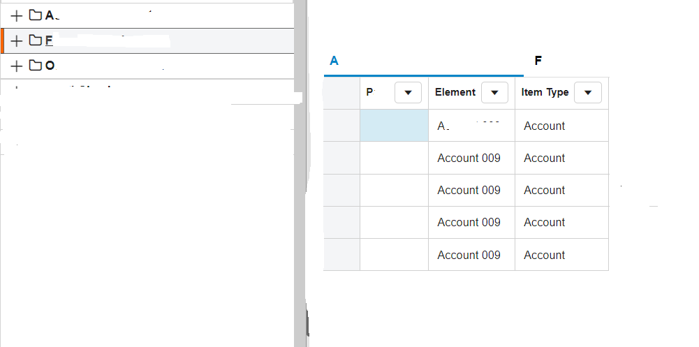

    In the above image. I have nodes in the left hand side. I have multiple tabs in the right hand side. we have grid as response in every tab.
    When we click on particular node I need to display the respective grid in the respective tab by calling API. I can able to get the grids in the tabs.
    But when I click on any node. Everytime first tab is getting highlighted in the multiple tabs. I need to highlight the tab based on what I clicked in the left hand side.
    In the below code I am getting index dynamically also (i.e., getting index as 0,1,2…) But that tab will not getting highlighted. Everytime first tab is getting highlighted. View is not getting updated

    To select a particular tab in the TabPanel, please pass the index to the selectedIndex property of the TabPanel. You need to handle the selectedItemChanged property of the TreeView and set the selected index accordingly.
    We are able to successfully change the selected tab on our end by using the selectedIndex property. In case, if you are facing an issue even after using this property then please share a working sample replicating the issue. You may also modify the attached sample such that it replicates the issue.
    Please refer to this sample for reference: https://stackblitz.com/edit/angular-ivy-4qspg6
