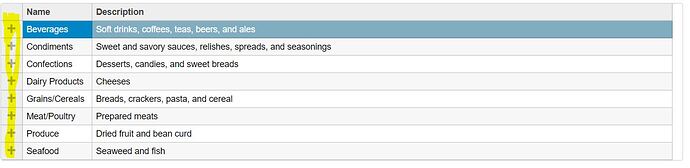

    I am implementing the row detail grid explained in Demo every thing works fine
    https://www.grapecity.com/wijmo/demos/Grid/Master-Detail/NestedGrids(RowDetail)/angular
    or shown in attached image as yellow
    i want to check if user has clicked the + Plus button on left hands side before expand or collapsing the row is there any way i can capture that event
  • Posted 17 August 2020, 2:07 am EST
    You will need to add a click event listener on the FlexGrid’s hostElement and check whether the clicked element is the detail button:
    this.gridDetail.hostElement.addEventListener('click', e => {
      var trg = e.target as Element;
      if(wjcCore.closestClass(trg, 'wj-elem-detail')) {
        var hti = this.gridDetail.hitTest(e);
        var row = hti.row;
        alert('You are clicking on row: ' + row);
    }, true);
    Please refer to the sample link below for reference:
    https://stackblitz.com/edit/angular-yzej2u

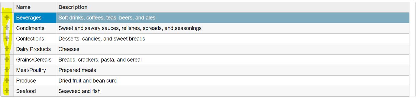

    Can i change the plus or minus button size to take entire cell as user wanted to click on the cell and its hard to find exact click on that plus/minus button as its small
  • Posted 18 August 2020, 3:59 am EST
    You can use the following CSS to increase the font-size of the plus/minus glyphs:
    .wj-flexgrid .wj-cell .wj-btn.wj-btn-glyph>span {
      font-size: 20px;
