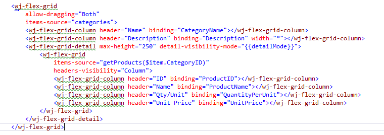

    Currently i am using wj-flex-grid-detail directive. Inside this, i have a ‘wj-flex-grid’ directive to show the detail table. How can i show all the detail table as default without click any ‘expand’ button when I load the page?
    Here is the example:
    Please refer to the attached picture.
    When I load the page, it will show “categories” table, and then i click on certain button, the ‘Product’ table shows up. Now what i am trying to do is when i load my page, the ‘Product’ table got expanded directly.
    Is there any way to do it?

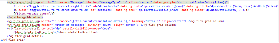

              I am new to wijmo. Got stuck in similar kind of problem. In my case, am opening a popup on click of EDIT button.
    This popup has wj-flex-grid.
              I want such mechanism where i can pass id of a record and the same record's detail
    should be open / Expanded as the popup opens.
              For your reference am attaching a screenshot. I am using an icon for toggling the detail ( dp.showDetail($row, true) )

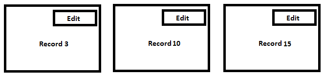

             Thanks for the reply, i have gone through the solution you suggested. What i can observe is the List data populated is same in both
    parent and child popup which fulfills the condition if row number is passed.
             In my case i have <strong>UN-ordered records</strong> which has <strong>Edit button</strong> please refer attached image.
             These boxes are active records from a list of Records. I will still refer the fiddle and try out some combinations if i can get the
    Expected result.

  • Posted 14 September 2017, 11:21 am EST
    You just need to pass the row which you want to display in grid detail through show function used in edit button’s ngClick attribute.
    Kindly refer to updated fiddle http://jsfiddle.net/mkgupta911/x800ojku/3/ as per your image.
