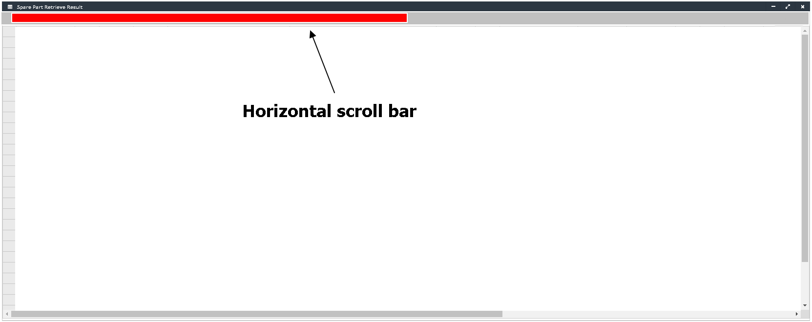

    Hello, everyone.
    I want to change the position of the horizontal scroll bar at the top, not at the bottom.
    How can I change my position? I’m waiting for your help.
  • Posted 29 January 2019, 2:33 am EST
    All the scrollbars shown in the wijmo controls are standard/system scrollbars.
    And they could be styled using CSS on browsers which support webkit-scrollbar like:
    .wj-flexgrid [wj-part=“root”]::-webkit-scrollbar {
    width: 5px;
    height: 5px;
    But as for the scrollbar position, browsers don’t support it yet.
    ~Sharad
