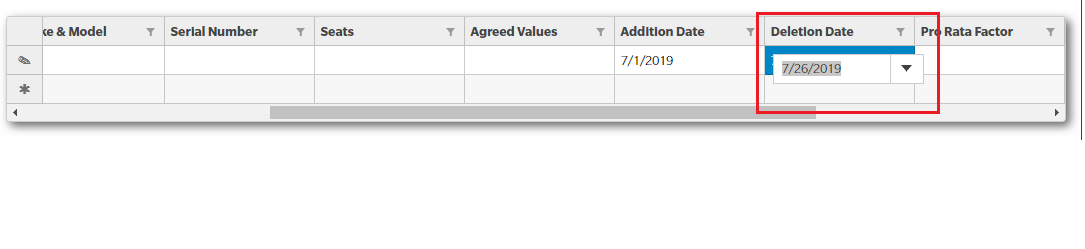

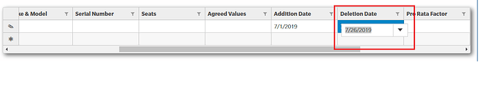

    3. The date gets re-positioned from its cell while doing editing. How to make the correct alignment ? I have attached the screenshot for your reference.

    1. We were able to replicate the issue at our end so we have forwarded the issue to the concerned team for further investigation with internal tracking id 392016. We will give you an update on the issue as soon as we hear from them. In the meantime, you can use the CustomGridEditor class provided in the sample attached.

    Thanks Ashwin, issue 1 and 2 gets fixed with this approach and even the mis-alignment of date-time-picker somehow also gets fixed with the click event handler of the grid until the website is not responsive. Once I change the layout of website; the date-time-picker control gets misaligned. So I am looking forward for the fix from your support team.

    The misalignment issue was in the sample itself. Please try using the CustomGridEditor class from the updated sample attached.
