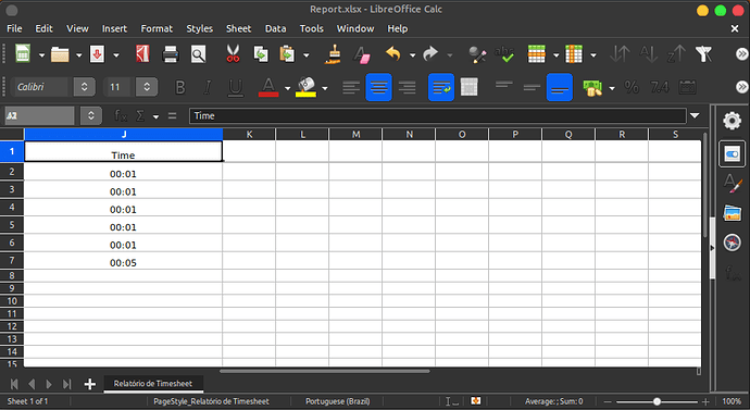

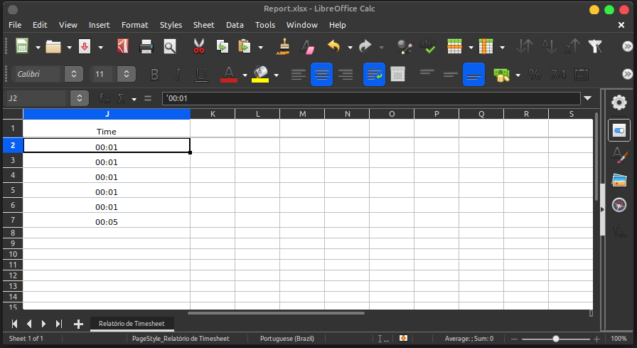

    Hi, I am using XLSX Export to generate a report, and I am facing a issue on a column that is representing the time spent on a task.
    This is column is on the format hh:mm.
    The document is generated just fine, but the problem is on the value of the cell that contain a the value as on the image below. And this impossibilite the use of Excel functions in order to sum the time.
    We already have a colum with the sum at the end of the report, but some clients wish to edit the values on the file and see the results beeing updated.
    Thanks for any help!

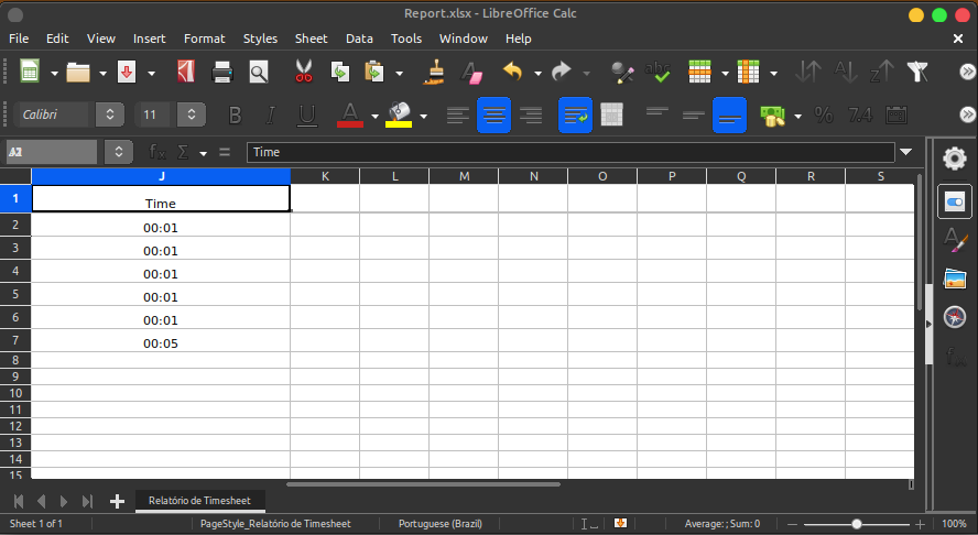

  • Posted 22 March 2021, 1:39 pm EST - Updated 3 October 2022, 2:14 pm EST
    Sorry… wrong image… the correct image is this one below.
