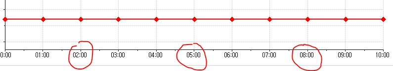

    Dear. Grapecity team.
    Can you select and display the time value of x-axis?
    For example, only the red circle of the attached file.
    thank you
  • Posted 26 May 2021, 1:04 am EST
    Hi Sungtae,
    Thank you for sharing the snapshot.
    You can display required labels for AxisX by using Axis’s DataSource and Binding property as follows:
