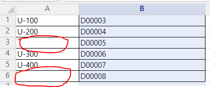

    I am trying to parse excel through LoadExcel function of FiexGrid.
    The data of the merged cell is not displayed.
    Is there any way to solve it?

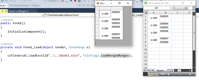

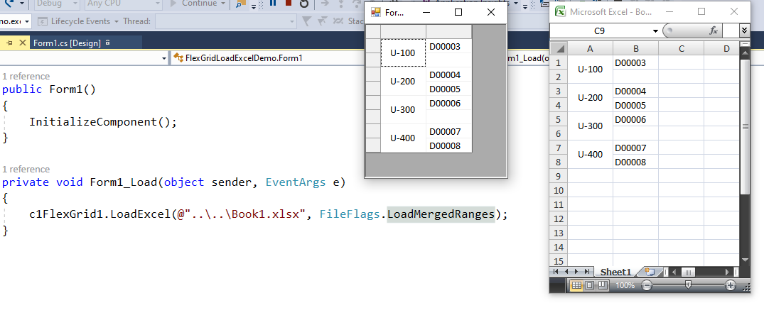

    You can use the FileFlags parameter as FileFlags.LoadMergedRanges to get the desired output. The code snippet is given below to do the same:
    c1FlexGrid1.LoadExcel(@"..\..\Book1.xlsx", FileFlags.LoadMergedRanges);
    If you need any other help, please let me know.
