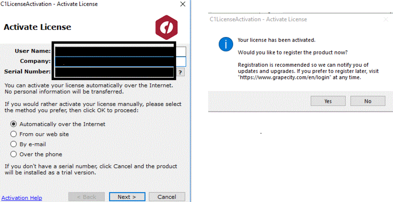

    By using this link:
    http://help.grapecity.com/componentone/NetHelp/c1studiowinforms/webframe.html#ComponentOneStudioLicenseandKeys.html
    I have activated the key we payed for.
    The output message is: “Your license has been activated”
    But yet when I run any application the ComponentOne Evaluation popup appears,
    Though now it appears only one time on each run, and not several times.
    Any help will be appreciated
