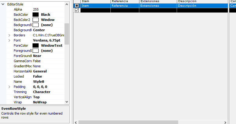

  • Posted 9 August 2022, 10:23 am EST - Updated 3 October 2022, 10:16 pm EST

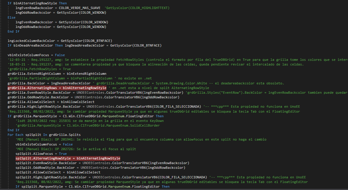

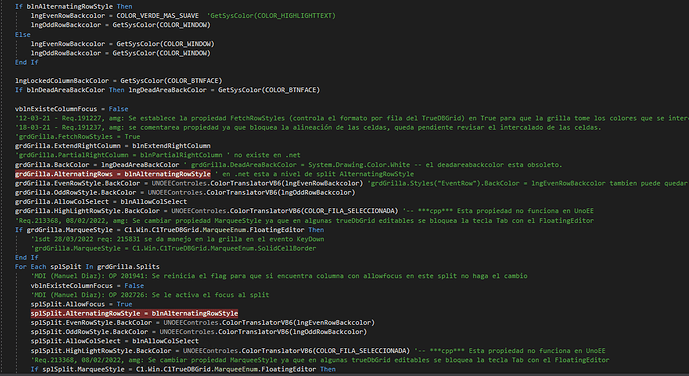

    Since you did not provide a sample, we were not able to completely debug your application, but we tried to copy all the relevant code from your screenshots into a sample.
    As per our understanding, we found a piece of code where you are trying to apply styles over the DisplayColumn and that might be the code causing the issue, as applying Styles on columns will always take precedence over the Odd/Even Row styles. Kindly refer to the attached sample in which we have commented out the code we are talking about.
    We suggest that you remove/rewrite this code accordingly and see if you still face the issue. If the issue persists, it would be really helpful if you provide a small sample or update the attached sample to show the exact issue along with the implementation you have done.

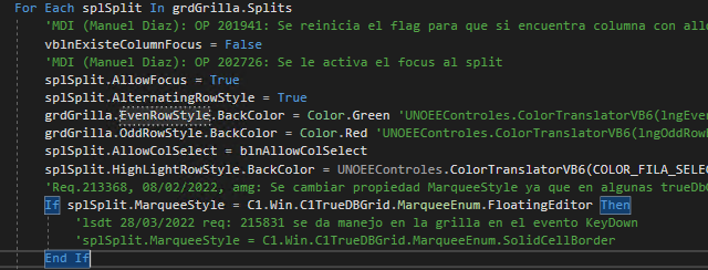

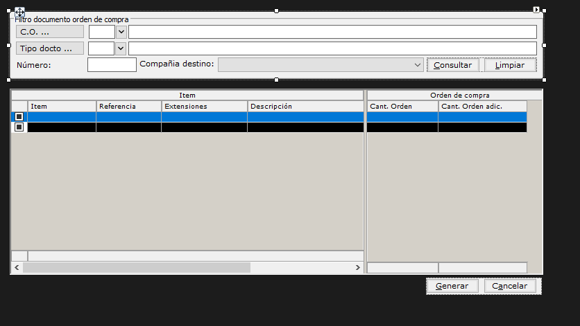

  • Posted 11 August 2022, 12:29 pm EST
    Hello. I attach an example project as it is being used in the original project, the strange thing is that the rows are painted black and the alternatingRows is not applied
    Something to take into account?
