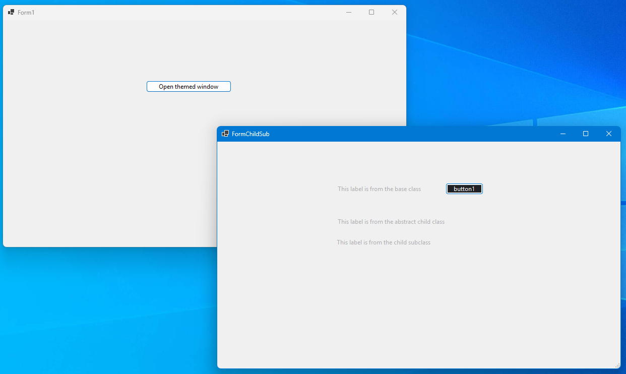

    The theme is not applied to this form.
    See attached sample ThemeControllerAbstract.zip: the class “FormChildSub” has a abstract base class “FormChildAbstract”, which has a base class “FormBase”.

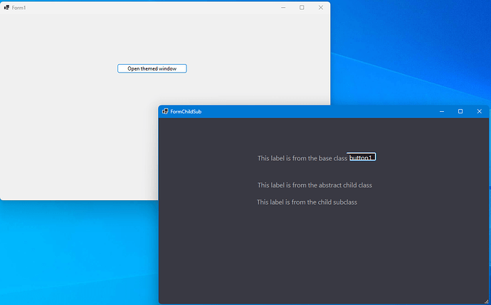

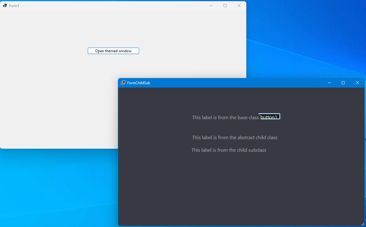

    When applying a theme to an instance of “FormChildSub”, the form itself is not themed:
    It works if the base class is not abstract:

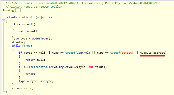

    ILSpy pointed me to this piece of code where a “IsAbstract” check is done:
    Is there any chance to fix theming of forms with abstract base classes? Or is there a reason that makes it impossible for you to support this?
