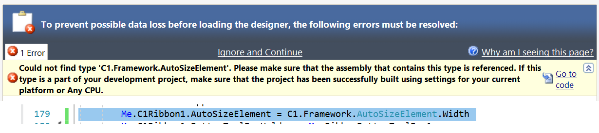

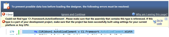

    From time to time I get the below error when opening up a form to edit.
    I simply remove the offending line and the form loads with no problems. The error will return when the form.Designer code is regenerated, which is annoying. How do I fix this?

    Thanks for sharing the screenshot.
    It seems that you are missing a reference to “C1.Win.4 dll”, that contains AutoSizeElement. Can you please check the same and add the reference if it is missing? Clean and rebuild the solution before viewing the designer again.
    In case the issue persists, please share a screenshot of your references.
