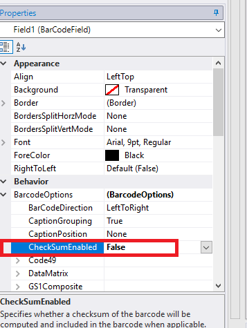

  • Posted 17 January 2019, 12:46 am EST - Updated 4 October 2022, 1:40 am EST
    If you are not using barcode with check sums, you can set the CheckSumEnabled property to FALSE. This should help you avoid getting additional bytes encoded in your field.
    If the issue persists, kindly share a demo report showing the issue and I would look into the same in order to assist you further.
