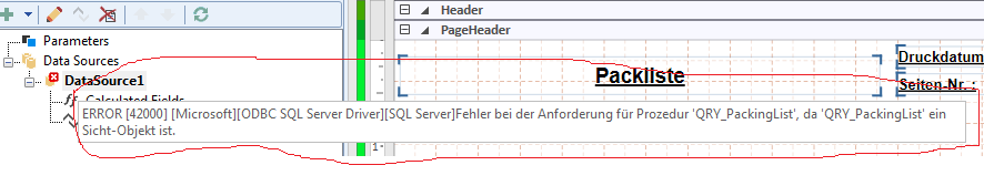

    The following issue started after some CO update. I could binde a query in a Flexreport. Unlikely since some weeks not. ODBC Error no 42000. This tells: The report cannot binde the query because it is a querry. I do not understand what is going on. The odbc Connection is running well. I can also see all the list of the tables and the views. After the OK, the fechting data source Information is taking more than 20 minutes and at the end i got the error 42000.
    Can you please explain what is goin on?

    Under Datasource1 = Error 42000
    Liste of the fields to be used in the report = 0

    Is this not amazing that i cannot see the field list under the Datasource1. It is always fetching …

    In the C1Flexreport the Connection is no Problem but later i cannot see the query fields to be populate in the Report. As mentioned it says fetching and after 20 mn i get the Error mentioned 42000.
    The Error 42000 must be known from the CO expert. C1Flexreport is giving it out.
