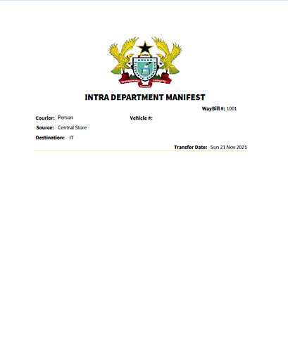

    Am using Flex Report and I have Main Report and a Sub Report. The Sub Report contains list of items from a database. The Main Report contains a memo and Sub Report Field. The problem is when the list of the Sub Report is long and can’t go on the first page it moves to the second page but I want the list to start from the first page and continue in the second page. Below is an image of my problem.

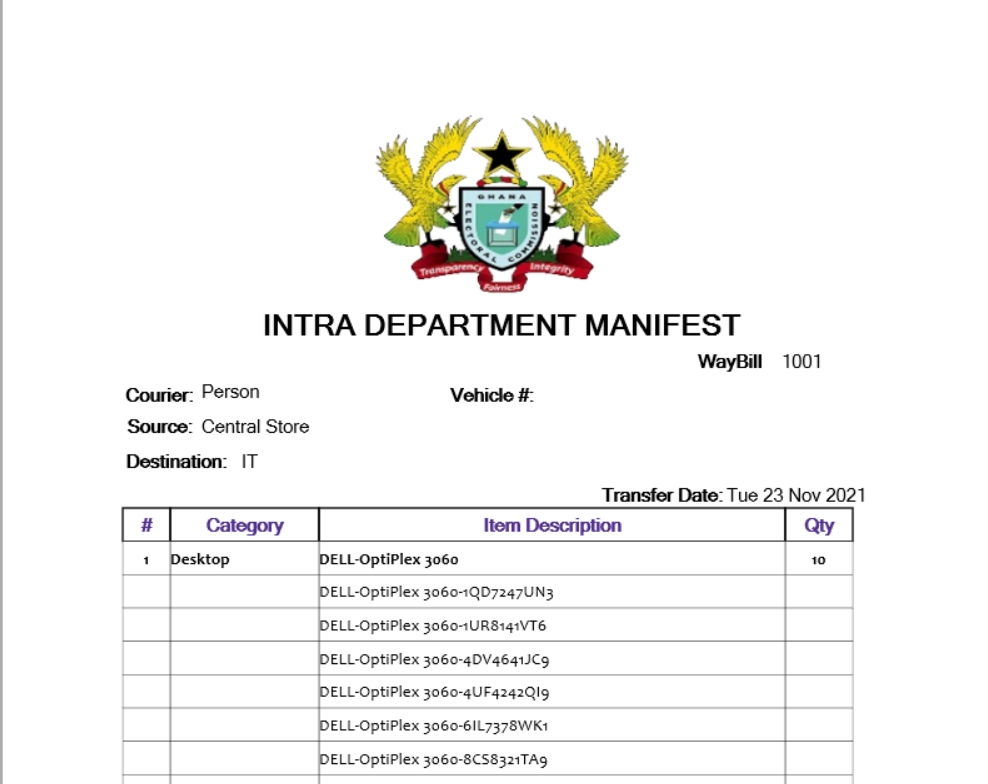

    We do not face the issue at our end. Please find the attached report file implementing the same and let us know if you are doing anything else.
    Also, modify the report accordingly so that we can assist you further.

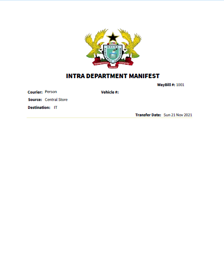

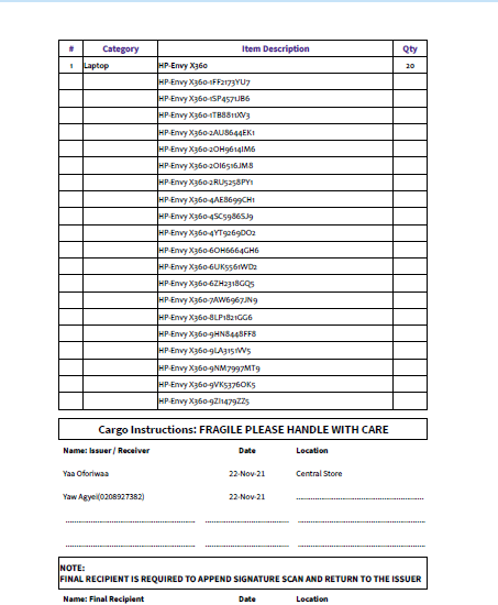

    The Sub report contains another Sub Report which has a Sub Report Filter. In the second image on the first line is the first Sub Report and from the second line is the second Sub Report and it looks the first and the second sub report are combined as one so if the space on the page is too small then it moves onto the next page but I want it to continue. I have added my report and the database file

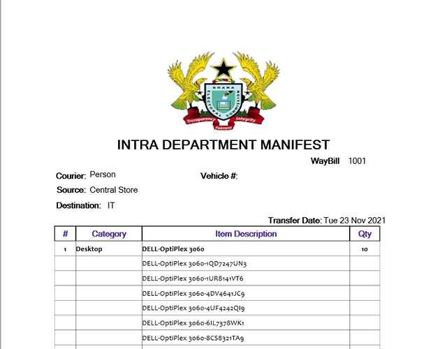

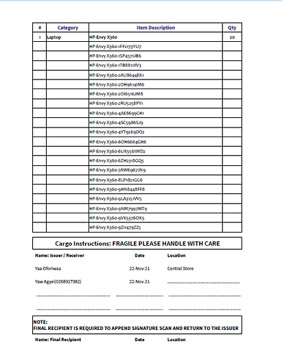

    The issue is not reproducible with your attached backup file as shown in the attached screenshot. Please provide the db file which can reproduce the issue so that we can assist you further.
