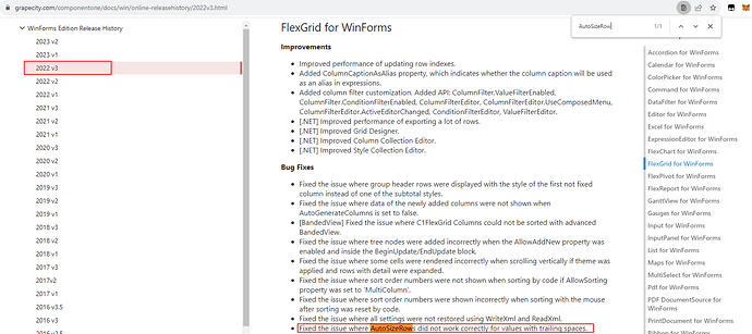

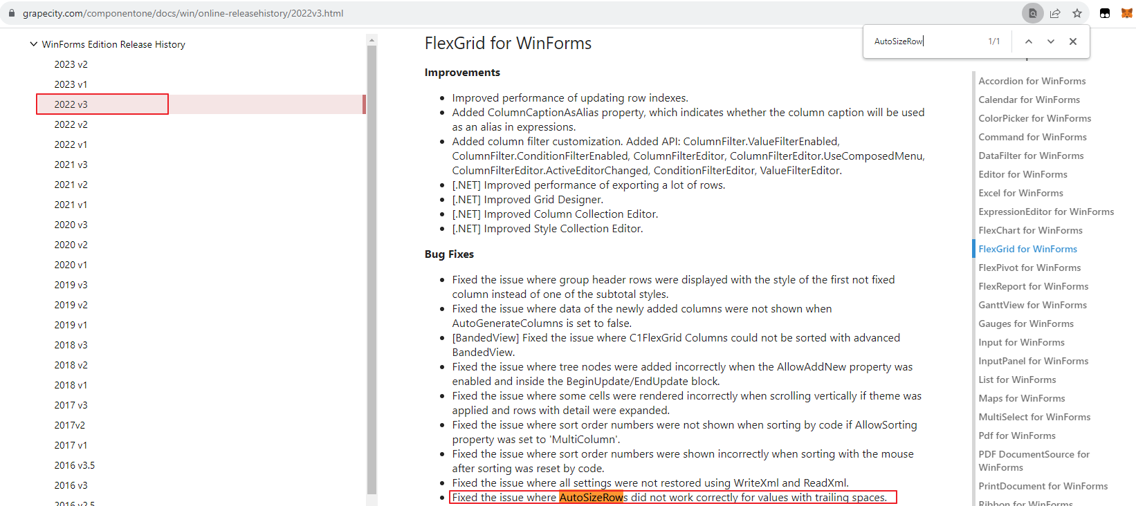

    I’m currently finding the root cause for the issue where AutoSizeRows() does not work properly for values with ellipsis character in FlexGrid.
    The version that my application using is 4.5.2022.566 for C1.Win.C1FlexGrid
    However, this issue could not reproduce after I upgrade it to 4.8.20223.588 for C1.Win.C1FlexGrid.
    Then, I saw there is bug fix regarding this AutoSizeRows() as shown in diagram below:
    I would like to confirm with you if this bug fix fixed the issue that I faced in the version stated.
