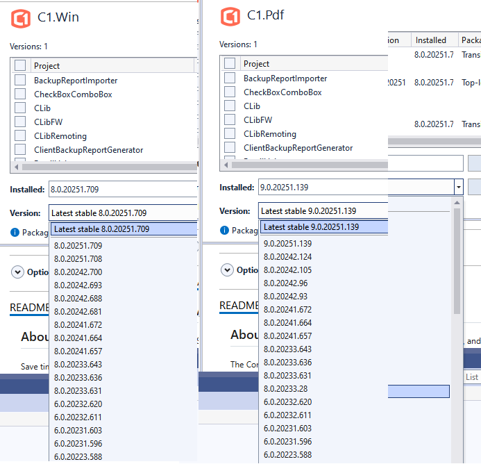

    Okay, I thought I would just point it out, because the divergence of these packages only appear to have happened on the most recent update. In other words, C1.Win stayed on 8.x whereas the others moved to 9.x… whereas before that point they moved with each other.
    I’ve attached a screenshot.
  • Posted 17 June 2025, 12:42 am EST
    Hi James,
    Yes, the divergence began with the latest 2025v1 release. Regarding the screenshots you shared - since C1.Win is a WinForms-specific library, it follows the WinForms versioning scheme. On the other hand, C1.Pdf is now a .NET Standard-based library, and therefore follows a different versioning approach aligned with our .NET Standard versions.
