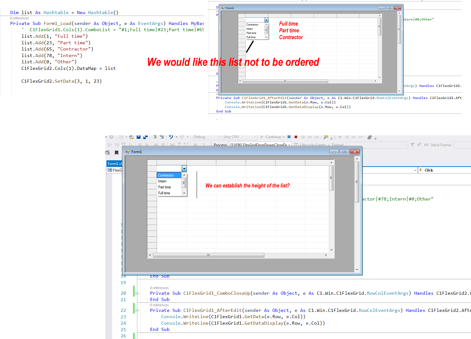

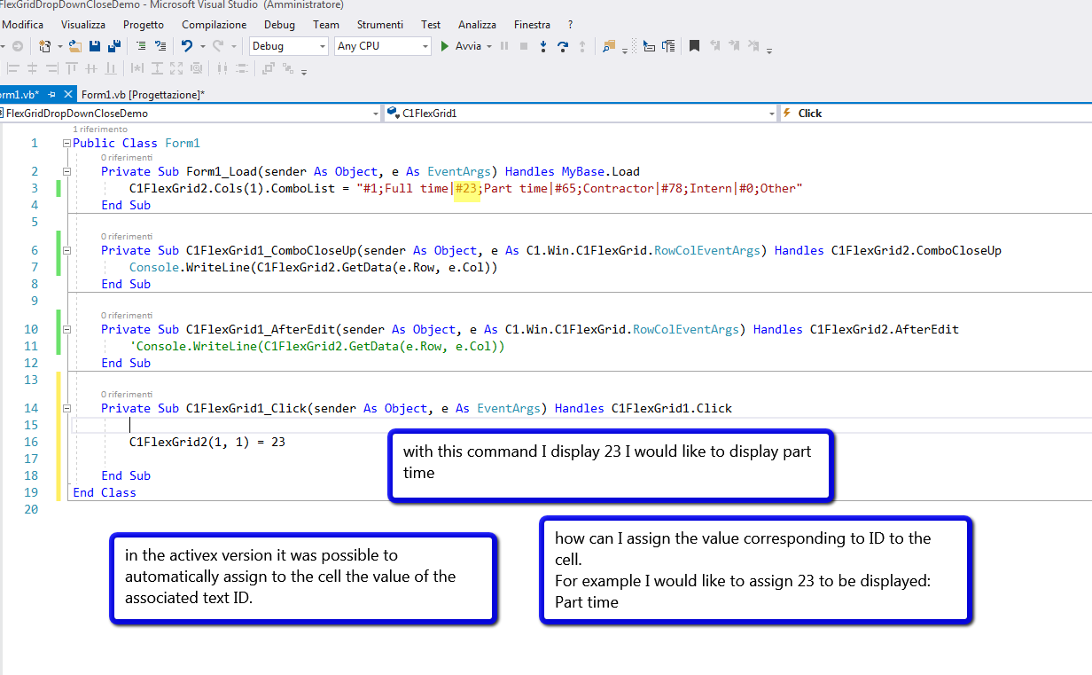

  • Posted 2 October 2019, 10:27 am EST - Updated 4 October 2022, 12:44 am EST
    Hi
    Thanks for the reply you can see attached image
  • Posted 3 October 2019, 12:27 am EST
    You can achieve your desired behavior in WinForms’ FlexGrid using the DataMap property where Key part of DataMap is assign as Data for cell and Value part as DataDisplay.
    More more information please go through the given link :
    https://help.grapecity.com/componentone/NetHelp/c1flexgrid/webframe.html#C1.Win.C1FlexGrid.4~C1.Win.C1FlexGrid.RowCol~DataMap.html
    I modified the last attached sample demonstrating the same, please have a look.

  • Posted 3 October 2019, 12:02 pm EST - Updated 4 October 2022, 12:45 am EST
    Hi Sharma
    Thanks for answer
    thanks for the answers I ask you for a last help see the attachment.
    filippo
  • Posted 3 October 2019, 11:55 pm EST
    1 : To show the list not in the ordered position you can use ListDictionary in place of Hashtable.
        Dim list As ListDictionary = New ListDictionary()
    2 : To set the height of the DropDown take Editor of the cell as ComboBox in SetupEditor event of FlexGrid as given in code snippet below :
    Private Sub C1FlexGrid1_SetupEditor(sender As Object, e As C1.Win.C1FlexGrid.RowColEventArgs) Handles C1FlexGrid1.SetupEditor
            If e.Col = 1 Then
                Dim cb As ComboBox = C1FlexGrid1.Editor
                cb.DropDownStyle = ComboBoxStyle.DropDownList
                cb.IntegralHeight = False
                cb.DropDownHeight = 60
            End If
        End Sub
    Please refer to the attached sample demonstrating both of your requirements.
    If you need any other help, please let us know.
