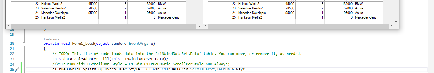

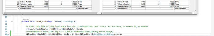

    This is the designed behavior and currently, this behavior can not be customized. As a workaround to keep the visual layout consistent across splits, you can set the Horizontal scroll to be displayed always by setting the Style property of the HScroll of the splits to C1.Win.C1TrueDBGrid.ScrollBarStyleEnum.Always. Please refer to the image attached.
