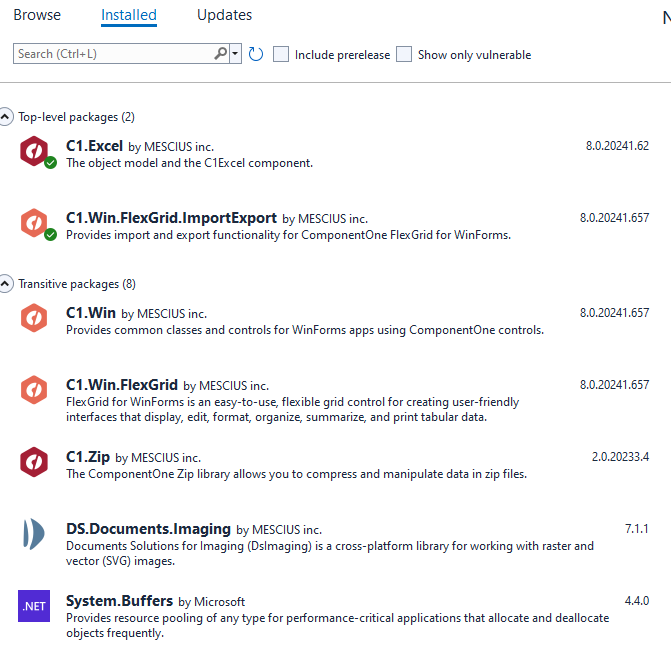

    the Nuget package “C1.Win.C1FlexGrid.ImportExport” 8.0.20241.657 has a dependency “GrapeCity.Documents.Imaging, Version=6.2.5.0”:
    If you add the package “C1.Excel” to the project, this dependency vanishes and seems to be replaced by “DS.Documents.Imaging.dll”:
    See attached sample: FlexImportReferences.zip
    I noticed this problem because we have code that crawls all loaded assemblies and tries to resolve their dependencies. This code now crashes because “GrapeCity.Documents.Imaging” is not found.
    First workaround is to ignore this assembly. But it is probably required (maybe when a C1FlexGrid with cell images is exported to excel). So, could you comment on this situation? Is this dll needed or is it safe to just ignore it?
  • Posted 4 June 2024, 2:26 am EST
    OK, my error - “C1.Win.C1FlexGrid.ImportExport” already brings a dependency on “C1.Excel”, but currently an older version. There is no need to define the “C1.Excel” Nuget package. Don’t know why I previously added this in our code.
