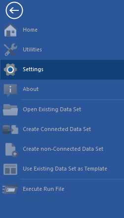

    In our Winforms application with C1Ribbon and C1BackstageView, we dynamically change the enable state of some items on the backstage view:

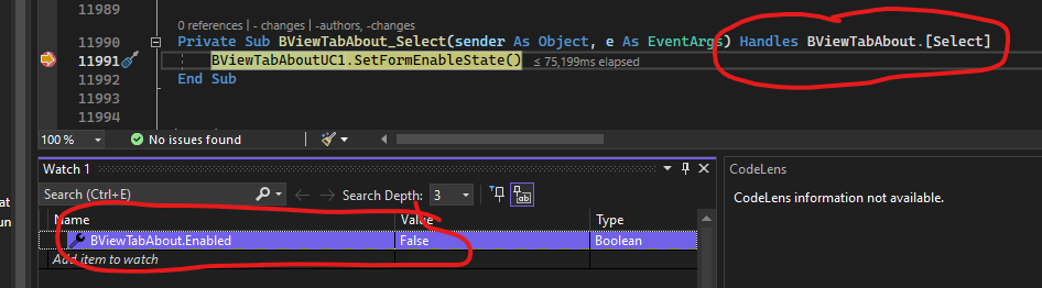

    However we have discovered that even when disabled, tabs can still be selected. Pressing the down arrow (while the Settings tab on the backstage view has focus), moves the selection down to the About tab, and fires BViewTabAbout.Select. This should not be possible with .enabled = False
    See screenshot of the BViewTabAbout.Select being fired while .Enabled is False
    And the result is that the tab opens as if it is enabled:
  • Posted 1 December 2023, 1:14 pm EST - Updated 1 December 2023, 1:15 pm EST
    To clarify, perhaps allowing the tab to be selected is okay… the issue is that the contents of the tab get loaded into the righthand side of the backstage when the tab is selected (even when the tab is disabled).

    Hi Andrew,
    Thank you for sharing all the details. We could observe the issue you mentioned with the 2023v2(620) release. However, this issue seems to be fixed in the latest 2023v3(631) release.
    The 2023v3(631) release is currently available for installation from NuGet only (https://www.nuget.org/packages/C1.Win.Ribbon/8.0.20233.631). It will be available for installation from ComponentOneControlPanel in some days.

    Thank you, I have confirmed this fix in our project using 2023v3.
