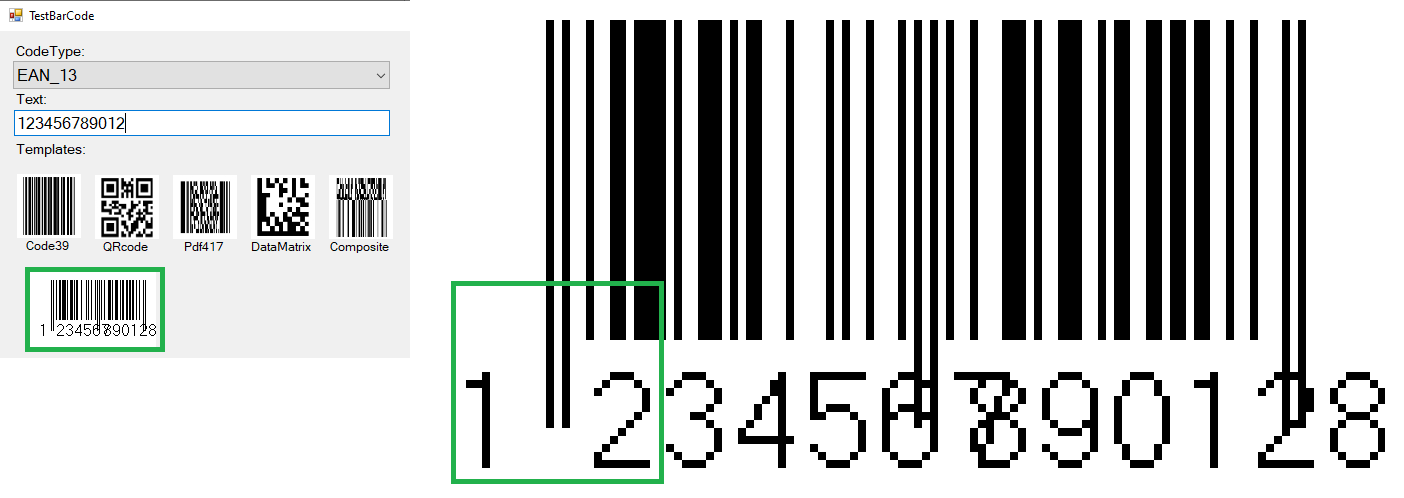

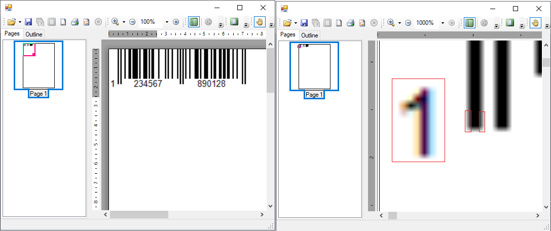

    Is it possible that when the image from C1BarCode is displayed in C1PrintDocument it will be sharp ie. in the same way as it is displayed in the C1BarCode component itself (like in the sample …\ComponentOne Samples\WinForms\v4.8\C1.Win.Barcode\CS).
    Here is the image in C1PrintDocument also with zoom
    Here is the image in the C1BarCode also with zoom

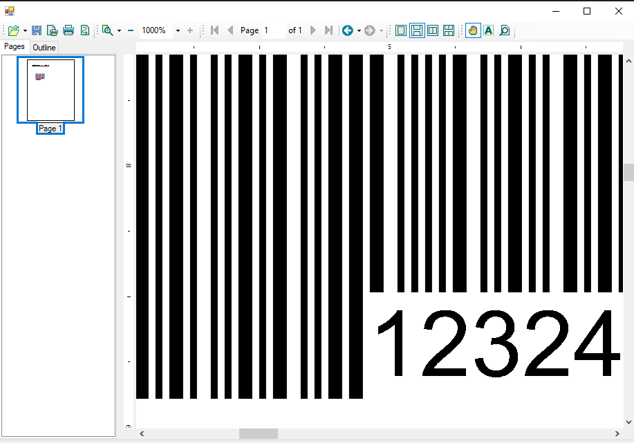

  • Posted 16 August 2022, 3:20 am EST - Updated 3 October 2022, 10:17 pm EST
    You can render high quality Barcodes on C1PrintDocument through RenderBarCode instead of RenderImage. (see code snippet)
            Dim barcode As New RenderBarCode(BarCodeEnum.Ansi39)
            barcode.X = 1.5
            barcode.Y = 2.5
            barcode.ShowText = True
            barcode.Text = "12324562662"
            barcode.Height = 1
            C1PrintDocument1.Body.Children.Add(barcode)
    Refer image of Barcode on PrintDocument:
    Please refer the attached sample for the same: C1PrintDocument_C1Barcode.zip
