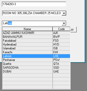

    I wish c1combo looke like the below image… (Autocomplete and fixed with using EMPTYROWS property)

    You can use the ItemHeight property of C1Combo to set the height for the items displayed in the dropdown. Also, you can set the EmptyRows property to do the needful. You can learn more about the same from the below mentioned documentation link:
    http://help.grapecity.com/componentone/NetHelp/c1list/webframe.html#C1.Win.C1List.4~C1.Win.C1List.C1Combo~EmptyRows.html
    For C1ComboBox, the height for the items can be set using the ItemMode.
    For C1ComboBox, set:
    ItemMode = C1.Win.C1Input.ComboItemMode.HtmlPattern;
    HtmlPattern = “
    {0}
