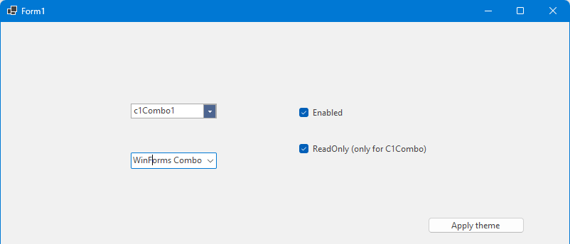

    See attached sample: I have a C1Combox which can be set to “ReadOnly” (instead of disabling it - normally this makes the text better readable, as the font color is black when it is read only).
    C1ComboTest.zip
    It works fine when using the bare C1Combo:

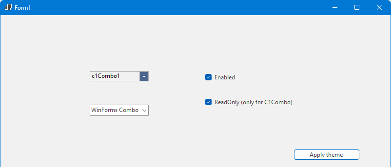

    But when applying a theme, it first seems to work (probably because the back color is not changed):

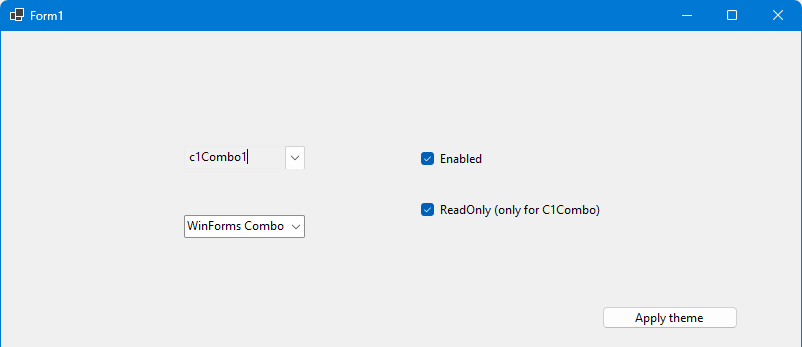

    But if you focus the combo and click outside, it reverts to white back color, which is not the read only appearance:
    Looking at the theme designer, I did not find a section for “C1List”, and I am not sure whether the section “C1Input” applies here, too.
    Is this feature missing in themes, or is it intentional to not have a “read only” theme part?

    Thank you for sharing the sample project. We could see the behavior you mentioned. We have shared the observations with the development team to get their insights on it and will let you know the updates as soon as possible.
    [Internal Tracking ID: C1WIN-34720]
