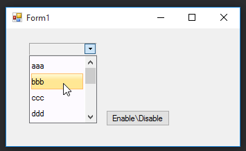

    I create ComboBox with DropDownStyle.DropDownList. The BackColor of ComboBox not change according to Enable Property.

    While running your sample with the build version 4.0.20181.307, I could see this expected behaviour :
    Hoping this is what you are trying at your end, I suggest you to rebuild and run your application with the same builds.

    But if you have no text into the ComboBox field, it is not possible to determine if it’s Enable or Disable

    Yes, it is an issue with the control. I have reported this to the team [Internal tracking Id : 329577].

    We are happy to inform you that a disabled style has been added for C1Combobox’s drop down button. One can’t change disabled back color of text area for the ‘System’ VisualStyle, but he can use other VisualStyle or themes.
