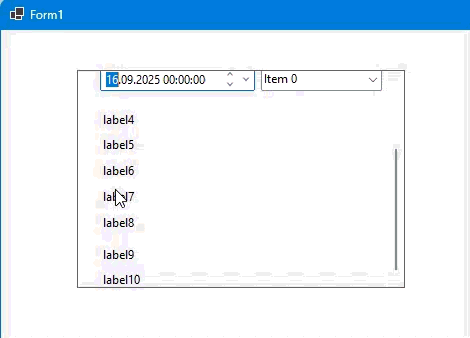

    this is a small annoying problem: if a C1DateEdit has focus and the mouse wheel is moved to roll date parts, this mouse wheel scrolling is handled, but afterwards it is propagated to the parent control, which also scrolls.
    In my sample C1DateEditMouseWheel.zip this is a Panel with AutoScroll = true.
    To reproduce: click inside the C1DateEdit control, let the mouse hover over it. Then use the mouse wheel => the parent panel is also scrolled.
    The winforms combobox does not show this problem.
