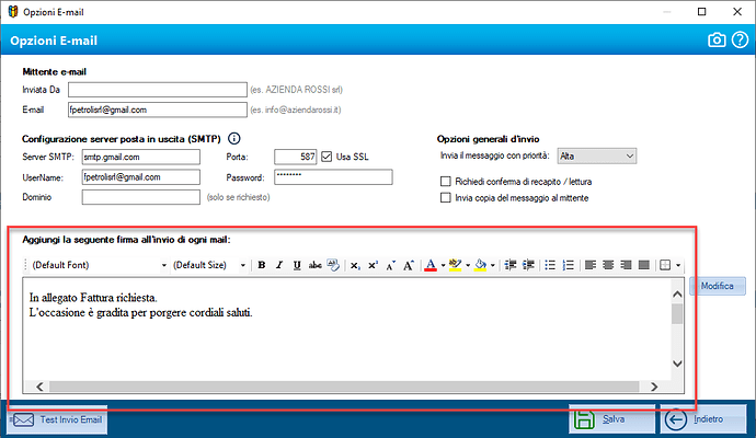

    Good morning,
    it would be possible to optimize the display of the scroll bars in the C1Editor.
    They appear active even if they are not needed and the UI effect is not exactly pretty.
    Thanks, regards,
    Marco

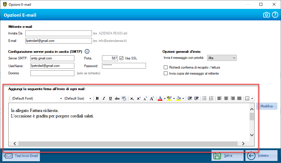

  • Posted 6 October 2021, 7:42 am EST
    Hi, thanks for the reply.
    I tried the code and it actually works.
    Unfortunately, basic functions are also disabled, such as select.
    At the moment it is best to leave the scroll bars waiting for you to resolve.
    Marco
