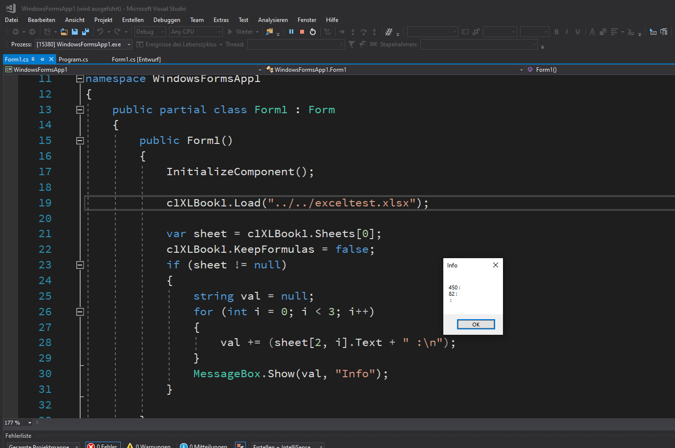

  • Posted 7 June 2023, 10:43 am EST - Updated 7 June 2023, 10:48 am EST
    and this (see screenshot) is the result of your attached sln running on my machine
    the sheet[2,2].text is just empty

    Hi Andreas,
    The sheet[2,2].text and sheet[2,2].Value both will be empty as there is no Value assigned to this XLCell. The value is calculated in the Excel sheet by fetching the formula via the ‘Formula’ property of this XLCell.
    Here I am quoting it again. Please check.
    " >to get the actual “Value” of a cell which has a Formula
    You cannot obtain the value of the cell via XLCell object until a value is assigned to it. If the cell has a formula assigned, the calculated value is not stored in the Value property of the XLCell object. Only the Formula property gets set as per the formula assigned to the cell."
    ‘Text’ property returns simple text representation of the current cell value. However, since the cell with a formula doesn’t have a value assigned to it directly, the text of that cell would also be empty.
    Please let me know if you need any further help.
